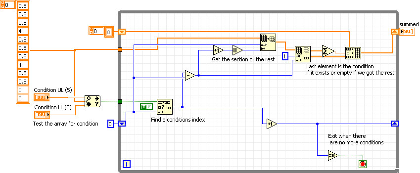

This should do it.  Interesting exercize.
Message Edited by Jeff Bohrer on 07-29-2009 01:03 PM

Thats why it was so interesting to solve.  see my previous post.  The code shown handels the above mentioned cases
