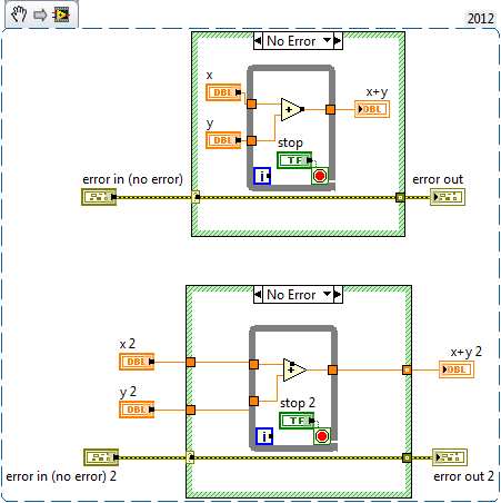

In this example:ci.png
The upper structure is less effecient since the three FP DBL objects are "conditional"  (they don't have value in the error case and are assigned default values )  in that case a new copy of the data is created and the output cannot reuse the input data buffer.

I tried checking the code provided by you using "Show Buffer Allocation" in LV2012.  I can see that both the code allocates same number of bufferes. i.e., the one which has Conditional indicator also created a buffer as below (Notice black square dot in Add function).  If conditional indicator does create additional buffers as you explained in previous post, why equal number of buffer is created in non-conditional indicators also?  Can you please explain this?
