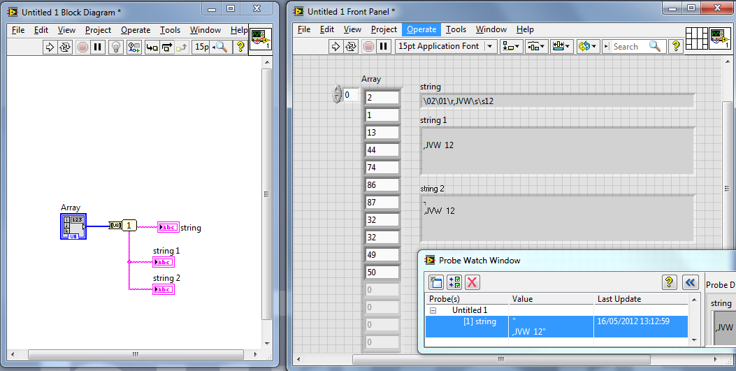

I think the problem is in the attached images, the image is the one I Labview2 runs OK, but the image Labview1 fails.
Why does the same program reacts differently?

I do not see any problem on your VI.
You have some difference on your probe because the font on your two computer is not the same.

Yes default font of your application. For example:
String indicator => shows the string in \ Code
String1 indicator => shows the string in my default application font
String2 indicator => shows the string in MS Sans Serif
The probe shows the result in the same format of yoru application font
=> it does not shows the same thing. Use a string indicator to test your function and set the font to a default one
Yoann
