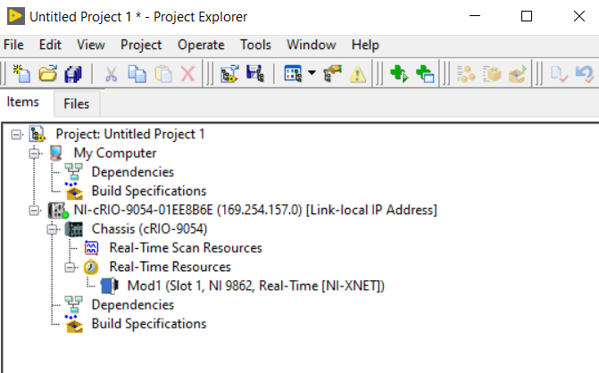

I created a new project as shown in the figure1 attached.
I expected to see the NI 9862 leds switch on but this doesn't happen, do you know why?

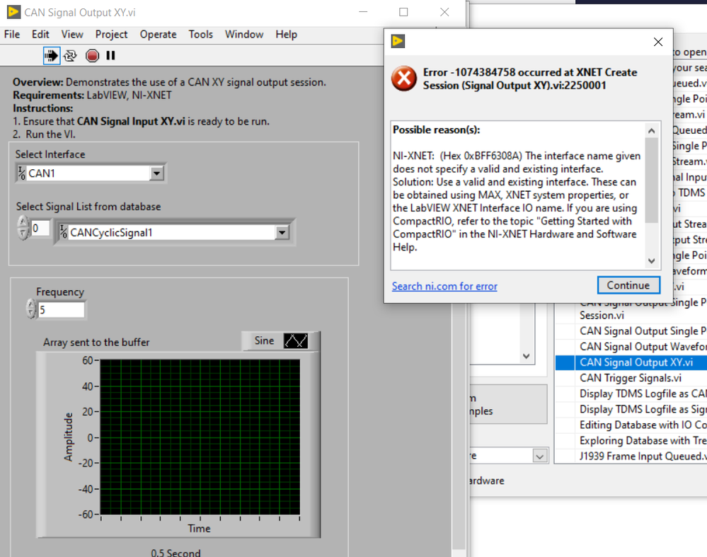

In the Help_Find Examples... section I searched for some examples compatible with NI 9862 (figure2) and I run some examples. I always got an error "NI-XNET : the interface name given does not specify a valid and existing interface..." (figure3).
I already installed all the requested drivers and I don't know how to solve this error, could you help me please?

what happens when you select CAN0?

if I select CAN0 nothing changes.
I connect the module and I can't understand why the module leds remain switched off.

Can you move the card up under Real-Time Scan Resources?

I can't move the module under Real-Time Scan Resources, I get this message

I managed to have the module leds blinking while creating a new NI-XNET Session, but after that operation, when I try to run a project, they switch off and I continue to have the initial error "NI-XNET : the interface name given does not specify a valid and existing interface..."
