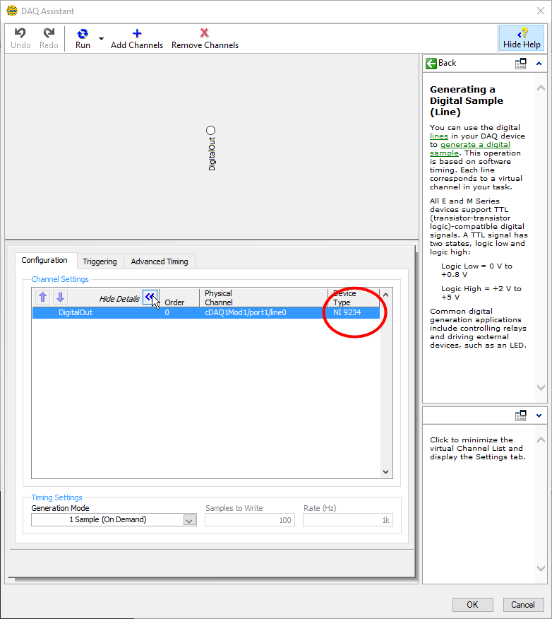

I was not able to verify the correct setting of your DAQ assistant - it shows a NI-9234 channel, but I don't know if that depends on my computer or on your settings. I also don't know what you refer to with AVO meter, but I think I noticed a small "misunderstanding" in your VI:

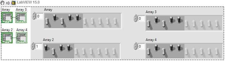

This does NOT output a one.
What you see there is an array control. So basically am indefinitely long list of booleans. However, you are displaying only one element of this list. The item you see is so to say a "keyhole" looking into your array. The numeric indicator defines what part of the array you are looking at.
Have a look at these:
The two controls on the left (Array and Array 2) both contain the same data (01011). However, on the second one I moved the "keyhole" one position to the right. The two indicators prove this.
So, in your VI, go back to position 0, and click the flipswitch to set it to "on". Hints: Using a digital button instead makes it easier to understand what position is on, and which is off. Also, please note that greyed out positions are not initialized, the boolean array does not contain these yet. Clicking the switch enables them. So, in your VI, the array contains actually zero(!) items, and those in my screenshot all contain 5 items.

  3. If you need to keep the DAQ assistant, verify that your configuration it correct. I find this in your VI and thing it's wrong:
