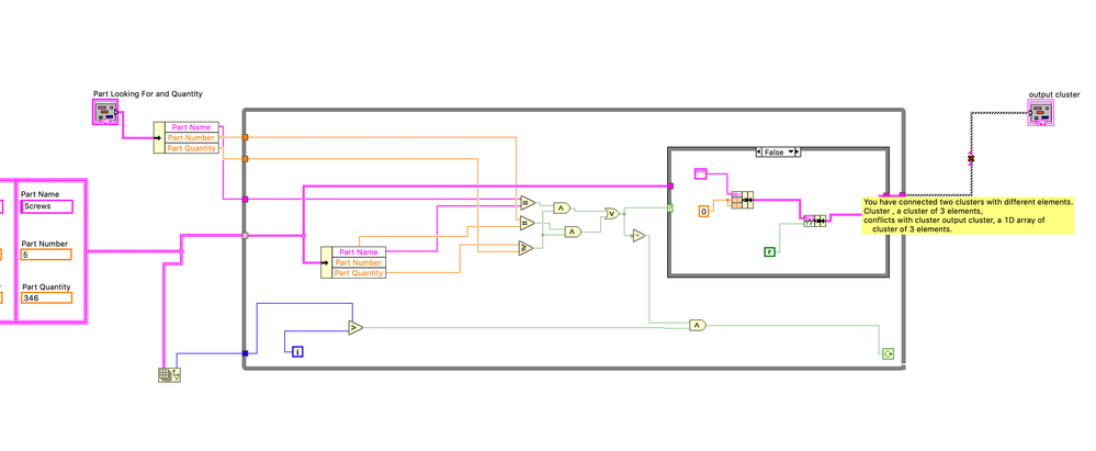

im pretty new to labview and im very confused by this error message. it says that my clusters contain different elements but they don't, ive tripled checked. Any advice would be helpful! im also using labview on a mac so maybe that the issue.

It's actually pretty clear message in that your output is a 1-D array of clusters while you input is not.  The image you attached shows you are bundling a cluster of a string and 2 doubles, then bundling that cluster with a boolean.  No array there what so ever.

For cluster to be the same, the datatypes and cluster order needs to match. Is your indicator a cluster of two elements, the first element a cluster of three elements (string, DBL, DBL) and a scalar boolean? Is it also the same in the other case? I don't see any arrays.

Forgot to attach the Vi, my bad. And as for the data types, Im taking 1 string input and 2 DBL numeric inputs and then in the case structure just adding a boolean indicator to the final output cluster, so I don think the data types are off, correct me if im wrong tho.

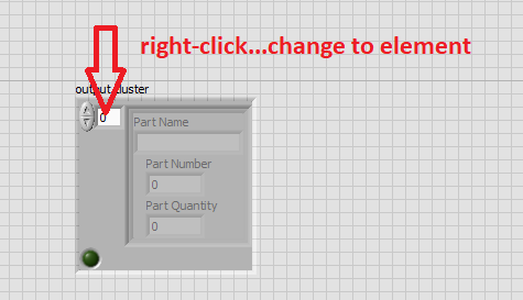

You cluster inside the output is an array of clusters. Do this:
Message 6 of 9

Thank you so much! This program is still confusing as hell to me, but il get though it.

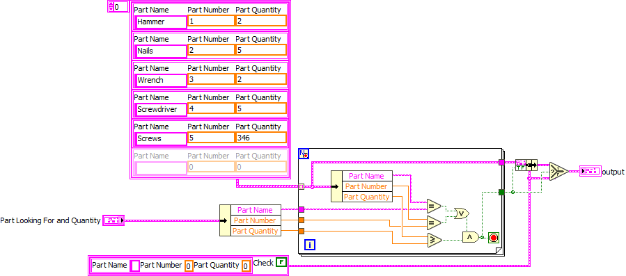

Maybe try something like this?
It probably need more error handling. For example what should happen if part name and part number don't match?
(I would strongly recommend to leave the "final" part out of any file name until it is a polished up and debugged!)
