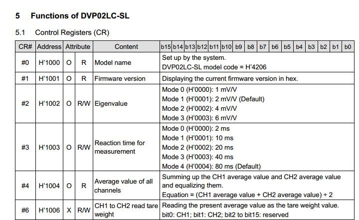

I'm trying to connect a loadcell module to read wieght using loadcells.
I tried to do this using LabVIEW 2012 and DSC toolkit. I did this using the tutrial provided here step by step.
But I can't read any register of this module. I think I'm doing mess with the register addressing. I'm not sure how I have to convert register address provided in the module datasheet to available modbus address. That's why I've tried different configuration of address.
The next to pictures show the addresses provided in datasheet and the one I tried to enter in labview.
What am I doing wrong?
