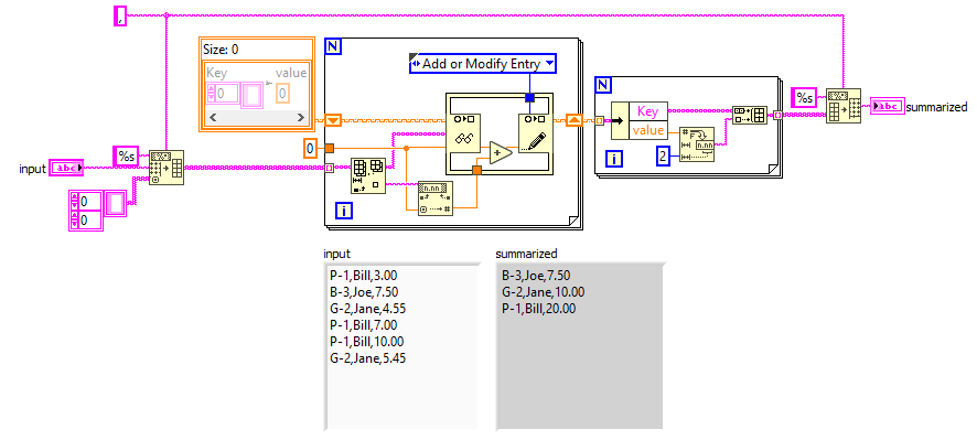

If you have LabVIEW 2019, a map (brand new datatype!) with key=user or key, value=array of DBL.
(Since you did not mention your version yet, we need to wait. Maybe something based on Variant attributes could be done for earlier LabVIEW versions. How big is the typical dataset? Is the key and person always matched?)

I just installed LV2019
Now, you mentioned this MAP data type?
Message 5 of 13
(5,267 Views)
Yes!
(If you want the keys in original order, some changes would need to be made.)

Awesome!
I took a more painful but successful route.
Message 7 of 13
(5,245 Views)
Well, now you know why maps are so great 😄
(even though I see quite a bit of room for improvements in your code ;))

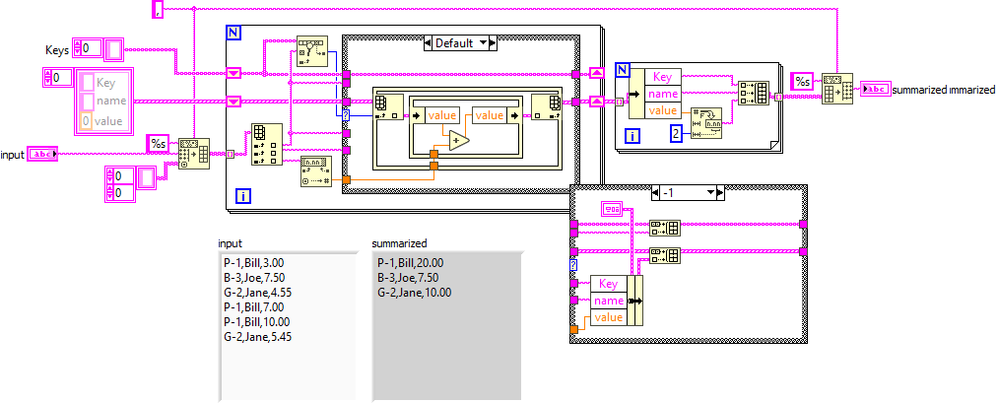

The MAP version is definitely preferred for large dataset, because the lookup is much more efficient. Just for kicks, here's a "noMap" version. This one keeps the element in order of first occurrence. There are many ways to do this, of course. 😉
