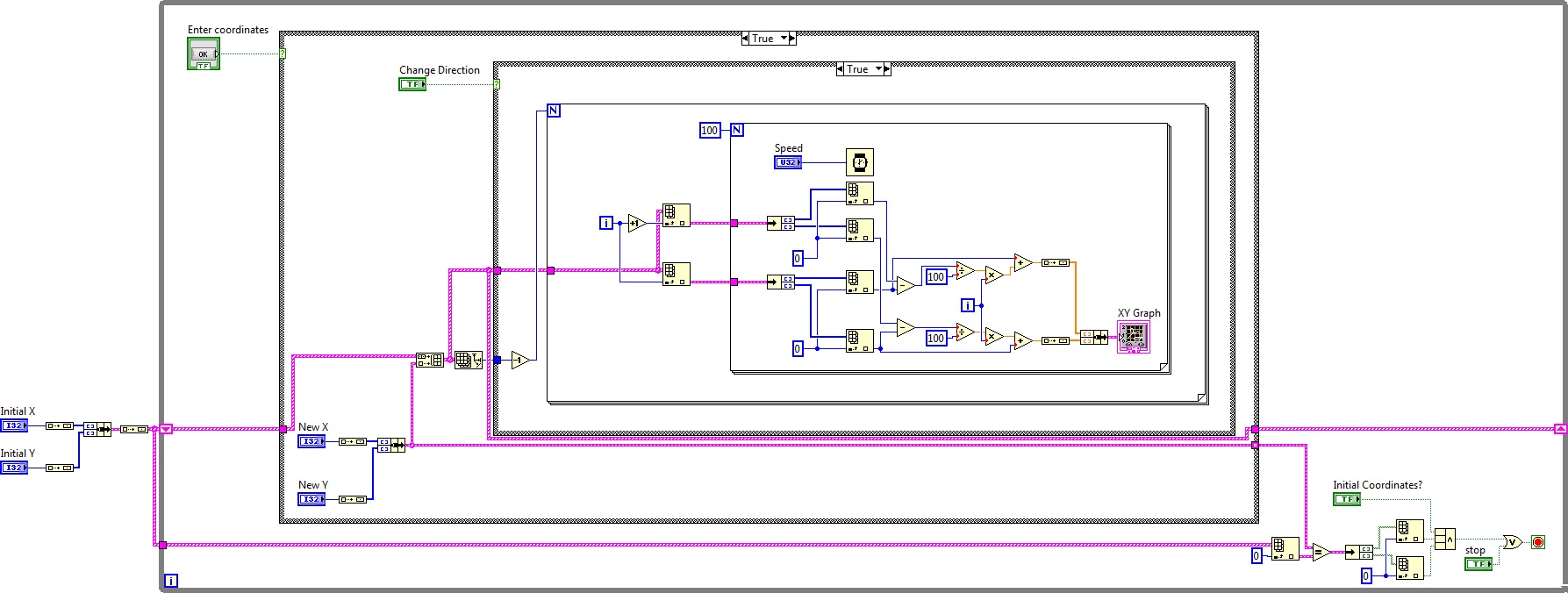

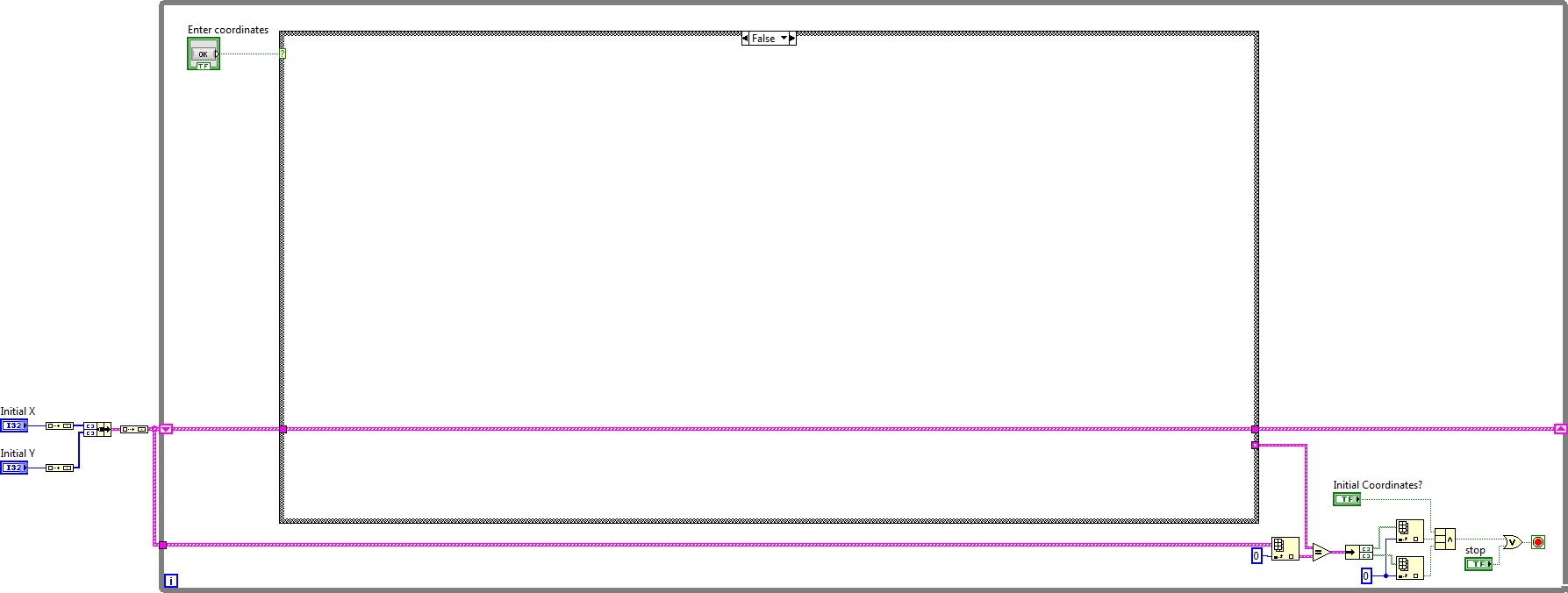

Hi Woody2230,
From what I understand from your statements it should be something as below?:
  1. Since it is to be looping in an iteration, a while loop is needed
  2. Within the while loop, there is a input for you to enter the XY coordinates. The XY coordinates is to be entered to the XY graph only if you press the enter push button.
  3. If push button is pressed to enter the coordinates, the current coordinates you enter is append together with the previous coordinates to the XY graph. Else, the previous value is to be inherited to the next loop.
  4. Since I need to inherit the previous data and the current data between loops, I need to use shift registers.
  5. At the mean time, I used a Search 1D array to search if the initial coordinates is the same as the final coordinates. Usually from my point of view, the initial coordinates should be at the index 0. If it is not within the array, it should show the value as -1.
  6. I have added an additional condition to specify further if the coordinates I entered is the final coordinates.
  7. If the final coordinates is the same as the initial coordinates, should stop the loop. You can also manually stop the loop.
Hope it helps
Warmest regards,
Lennard.C
Learning new things everyday...

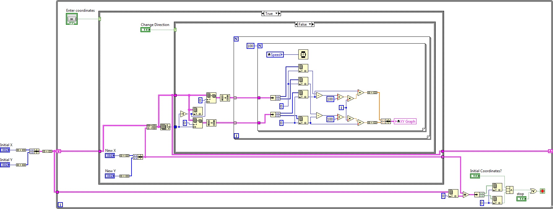

I have tried to integrate the plot points.vi and the 3 coordinates.vi. The result is the attached vi (I saved it as LabVIEW 2012). I believe the screenshots below of the code could explain how it works.
Hope it helps
Warmest regards,
Lennard.C
