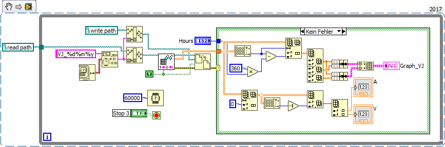

New to labview and have had a dig through the forums but couldn't find a relevant solution. I have two VIs (LV-2017), one in the lab continuously collecting data and writing a CSV file onto a network drive (every 2 mins). The other in the office, displaying the data by graphing the data from the network drive (reading every 10 mins). Each file is named in the format 'name_dd_mm_yyyy', so there is a new file created as the date changes and this is appended to throughout the day. This works fairly well except over the stroke of midnight where, based on the write and read intervals, occationally the read.vi looks for a file that the write.vi has not created yet. This, of course, causes an error and stops the read.vi from continuing.
What I'm thinking I need to do is either, somehow delay the read.vi to look for a file dated 10 mins in the past so there will always be a file when read.vi looks for it OR somehow enter some way of ignoring the 'no file found' error. I do not have the slightest clue how to do either. I'm using the 'Format Date/Time String' block to write the file name and append it to a path constant. Are there any tried and tested solutions that are used to handle this kind of thing?

there is NO errorhandling in your VI!
All those file functions support errorIO wires - USE them!
Hint: you can connect an error wire directly with the selector of a case structure and it will automatically present two cases of "error" and "no error"…

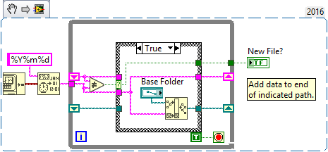

hank you for the clarification.  It also suggests the following extremely simple algorithm -- every time you need to write a file, create its filename in the form of YYYYMMDD.<whatever>.  By using a VIG (see below), you can detect whether or not the Date (= Filename) has changed, and set a New File? flag for further processing.  If the File is new, you'll want to Create it, write to it, and close it.  Otherwise, you'll want to Open it (for reading and writing), go to the end of the file, and write.
Bob Schor
P.S. -- Note I made the file name YYYYMMDD -- if you want it to be YYYYMMDD.dat, just change the format string to %Y%m%d.dat.
