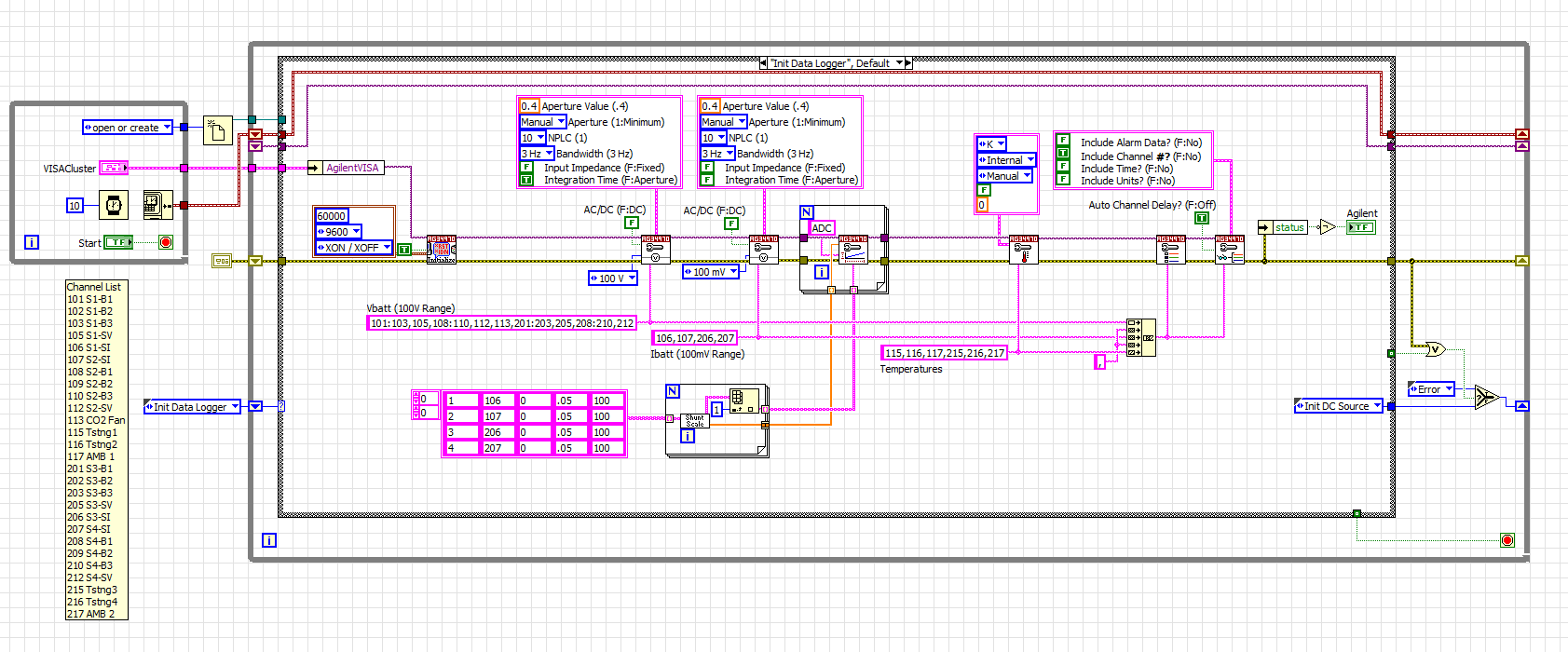

Here is an example of steps 1-3 configuring DC volts, Scaling DC shunts, K type thermocouples, and building a scan list.
To scan the instrument use the Scan-now vi that I attached. It will return a numeric array, string array, or CSV string containing each measurement.
Also don't be confused by my example using Agilent 34970 vi's the 34970 and 34972 are identical except for the communication options.

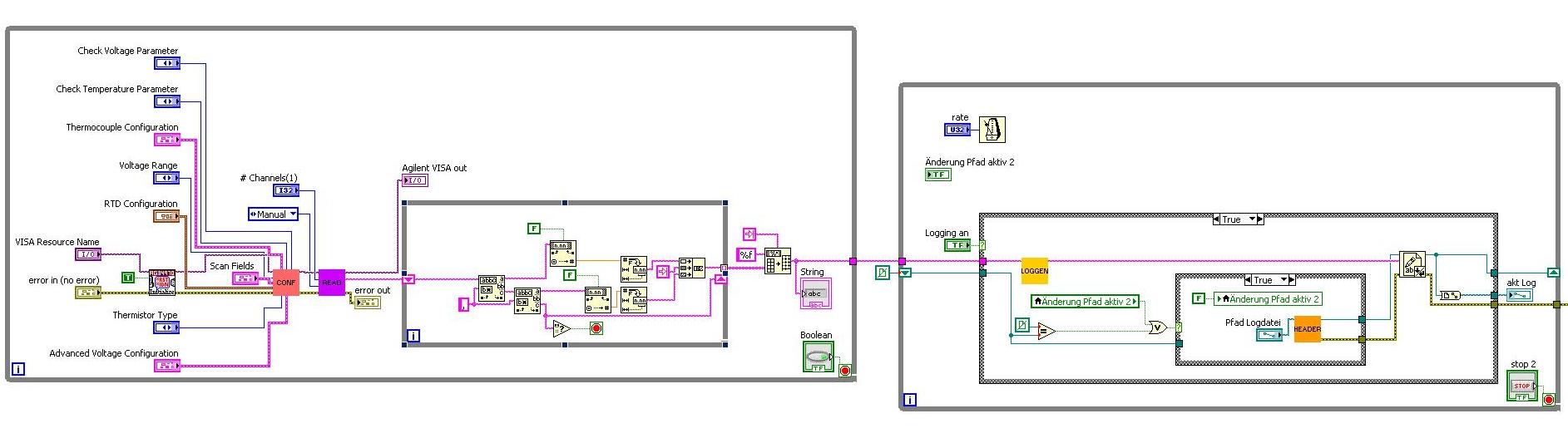

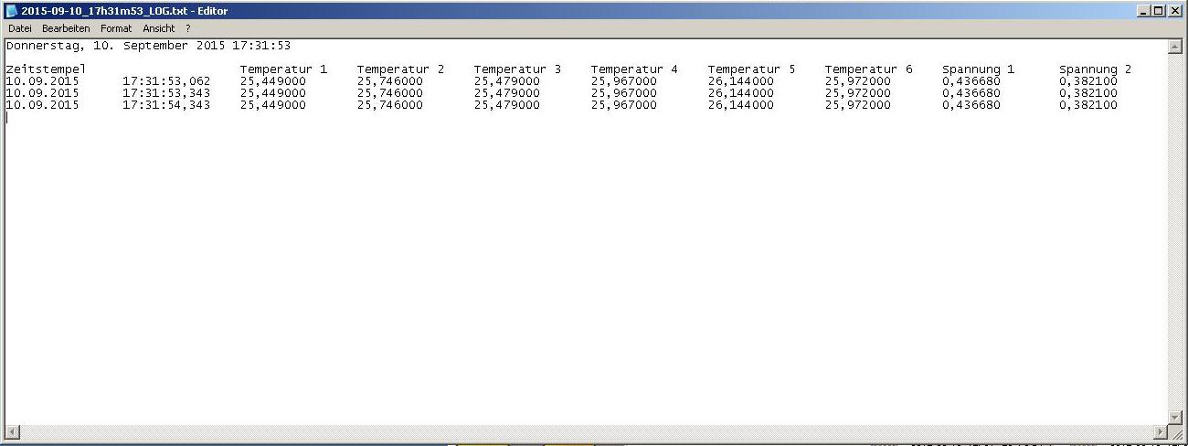

Thanks again for your help.
I changed my VI and the reading and scanning works fine.
Even my data logging part works well. But both together is not working the way I want to.
I am pretty sure that I have to use a While Loop but I don't know where to put it. I tried everything put my txt data looks always like in the attached jpg.
Can you help me fix my problem? Do I really have to use a While Loop or is there a function I don't know yet?
Message 8 of 17
(11,332 Views)
Yes, in order to continuously read, you must use a while loop. It should be around the scan and read function. The configuration should be outside the loop. The logging you have inside the loop makes no sense. I would suggest a producer/consumer design.
