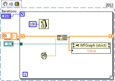

But you're trying to take a single data point, the random number during each iteration, and dump it into a table, which requires an array of data (in strong format).
If you used a shift register, and built up an array of random numbers like below, you could pass the array to a local variable at the end of each iteration. You can then, elsewhere, convert the array of doubles into an array of strings and feed into the table.
Edit - conversion in the other loop as follows:

The local variable is inside the loop, so it will read the contents of the array once every iteration. An empty array is initialised before the for loop, and then for each iteration a new element is appended, consisting of a random number. The new array is then passed to the Waveform Graph local variable and a shift register, which sends the array to the next iteration to have the next element appended.

Ah Ok, I see what you mean now. This helps me alot! I havent worked with shift registers or clusters very much, what is the WFGraph(strict) and value cluster for? What is the value you are pushing into the shift register on the left side of the loop? I'm trying to recreate the code from your picture but am having a little bit of difficulty.
