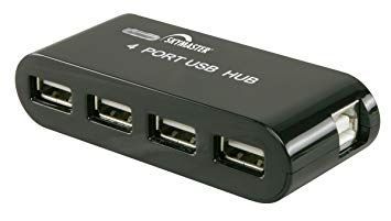

Hallo,
I used the attachment photo to connect the CTS and The HAMEG together in the same port is it right way or not??
sometimes I change the COM port so COM5 not fixed
Message 10 of 10
