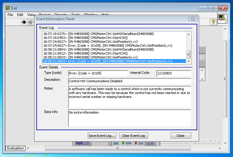

My lab bought a Thorlabs High-Speed Motorized XY Scanning Stages and controller for it (this one). Now I'm trying to make a program to control this stage with a keyboard (actually company has a standard software for control it, but it is difficult to use this program due to control with mouse and button on the screen). They have a manual (here) how to do this program, but it seems like I failed 😞 I attached a VI which I made. Also I made a printscreen with the error, but the device is detected by computer and all software installed (software is here).
Firstly I want to know what the problem is and then how to add a key control (for example A, D is for left and right correspondingly, W and S for forward and back). I have no idea how to do that, could somebody, please, explain me?

I am guessing that you are using an ActiveX component here. Where do you get that error message? Is it when you run your code? Have you tried running a simpler code just to make sure that you are having the right communication with the other software?

The error was in the wrong serial number, I guess. We have two-dimensions stage, so there is 3 SN: common one and one for each direction. At first I used SN for one of the dimension, but error dissapeared when I changed SN to common. But now I'm confused. How to control different dimension, how program can differ them without SNs?
