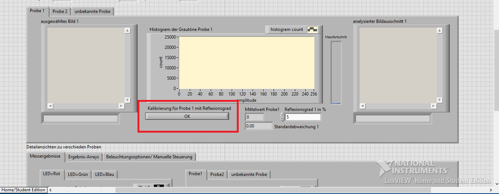

when I hit the  Ok button to measure reflection and  mean light intensity in calibration section, I don't get any reaction. It could work perfect before. Although I changed nothing, it doesn't work now. I send the pictures and program attached . I would be very thankful for any suggestion to solve this problem!

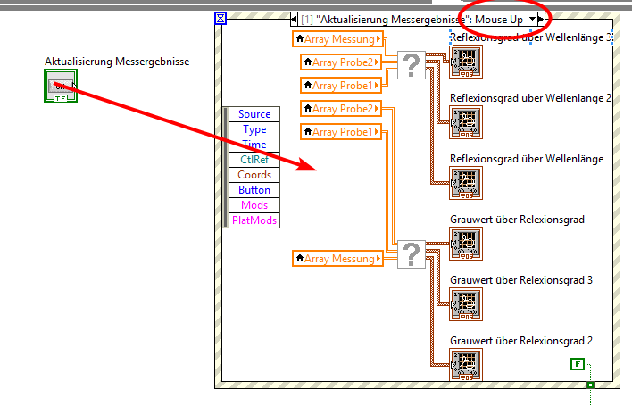

Hi Senol,
I guess that this is the button and part of your code we are talking about.
I propose two changes:
  • Move the button's terminal into the Event Structure. LabVIEW updates the button's look only when the terminal is read, which is inside the Event Structure in this case. So automatic "unpressing" of the button will only work when it is in there. Doesn't need to be connected to anything.
  • Change the Event to "Value Change". Mouse up could also fire an event when you press and hold the mouse button "somewhere", then move the cursor onto the button, and release it there. Kind of unexpected for User Interfaces.

Button "Kalibrierung für Probe 1 mit Reflexionsgrad" is problematic. When I hit this button it is pushed down but it doesn't take action  Other buttons work well. I moved the button into terminal and changed the event to "value change". But the event still doesn't take action. I put probe on the lines in the events "Kalibrierung für Probe 1 mit Reflexionsgrad", "Kalibrierung für Probe 2 mit Reflexionsgrad " ,  "Messung für unbekannte Probe durchführen" . I get errors on the line in these events. There is something in the program that disables taking action in these events.4.picture.png4.picture.png
