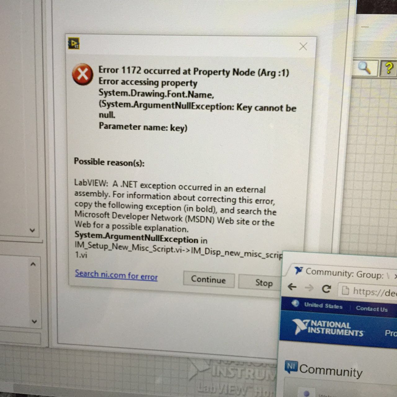

Control could not be found in Mathscript
Hi, when I opened Mathscript window in LabVIEW, there is a pop out saying "Error1172........." I accessed the Mathscript window anyway and I clicked "script" on the upper right of the page. There is a sentence in red saying "Control could not be loaded"
Could anybody tell me how to fix this! I will really appreciate that!

Hi! I do know that if your path to MathScript.ini is set to a network drive, Mathscripts can get a bit finnicky.
Check the path C:\User\<User name>\documents\LabVIEW Data. If your MathScript.ini file is not there, try locating it and placing it there.
If it is there, try the following:
1. Click on Tools >> MathScript Window
2. Once the MathScript Interactive Window opens up, click on File >> MathScript Properties >> MathScript: Search Paths and then define appropriate paths.
Finally, if all else fails, you may have to repair the installation of LabVIEW, as it appears a path may have been broken. I would try the following steps:
1. Control Panel >> Add/Remove Programs >> National Instruments Software
2. Select the most recent NI LabVIEW Run-Time Engine and click Repair
3. Restart PC
