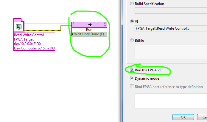

You can run fpga code by Invoke method or by "Run" option.
If you have free led indicator on your hardware, you can blink it when fpga works.
Or you can add bool indicator and switch it F->T after running FPGA code. If you read "F" value of indicator, code is not runned still.

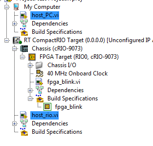

Tell me your hardware, please. I think I can make example for you.
Message 16 of 38
(4,391 Views)
Her it is,
CRIO-9073
NI 9237
NI 9401
NI 9505

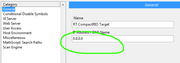

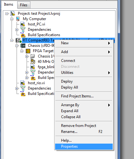

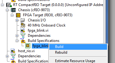

1) set property -> IP
2) compile FPGA code
3) now you can run host (rio/PC)
fpga code blink FPGA led on chassis.
also it blink two indicators with different frequency, if code fork, you can see it on chart.
LV15
Without your code and settings I can't say your errors.
