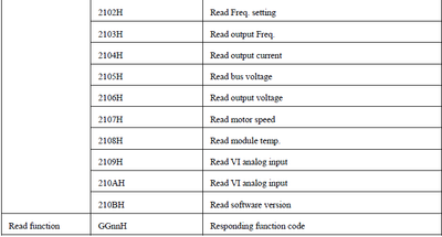

A very good post that I have read, have from the VFD manual the Modbus Decimal and Octal. In my VFD I dont have any of those. I am using the GK3000 VFD. In my case, I have info as the attached photo shows.
Any comment is appreciated.

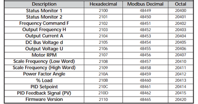

Thank you for your reply. These are data from other VFD (attached photo)
In mine VFD manual, I dont have any of those.... The link below is the manual.

Hello Gerd,
Thank you for you reply. Yes I have seen that but I cant find the Modbus decimal. Could you please be more specific which part of the pages that you told me to emphasize?
Thank you for your help.
Alex
Message 6 of 37
(6,307 Views)
Hi Alexis,
that VFD is set to ASCII mode by default. Usually Modbus/RTU is used with serial ports, so you have to change this setting on your VFD.
Starting from page 128 the messages and supported commands are described, with an example for ASCII and RTU mode each. The VFD only supports the Read and Write commands, and for both you just have to give the register number you want to access - as explained in the example data structures in that manual…

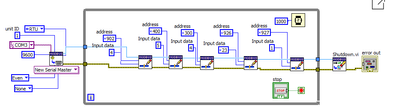

Hello GerdW,
First let me thank you for taking the time to reply on my questions. Regarding the post of the other person, he/she putted the following:
I cannot understand why he/she added 5 "write single holding", and how you come in the idea that you need 5....
Also the input data and the address is changing for each one of those. How you are coming in those values..??
Will be extremely glad if you can answer me those questions.
-Alex
Message 8 of 37
(6,289 Views)
Accepted by topic author Alexis_Koul
Hi Alexis,
This other person is writing 5 different values to 5 different registers/addresses.
Why did (s)he do this? Probably there was a requirement to set just 5 registers to specific values…
Where did (s)he get the register address from? Most probably from the manual of the device…
Your manual also list several addresses and their meaning. Just use them!
