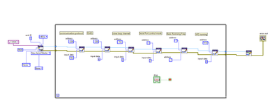

Based on your feedback, I Changed the VI as the photo attached. Unfortunately still the motor doesn't run.
Not sure what I still have to changed. Looks that I am getting closer, but still...
Message 26 of 37
(1,967 Views)

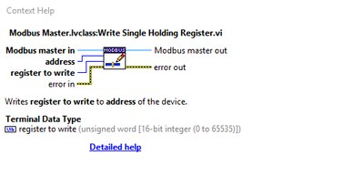

Hi Alex,
can you show the context help of this ModbusWrite function?
Why are the constants holding the parameter value labelled "unit"?
Message 27 of 37
(1,962 Views)
Thank you for your quick reply.
For question 1:
For question 2: I wrote them like this..
Looking forward to your reply,
Thank again.
Alexis
