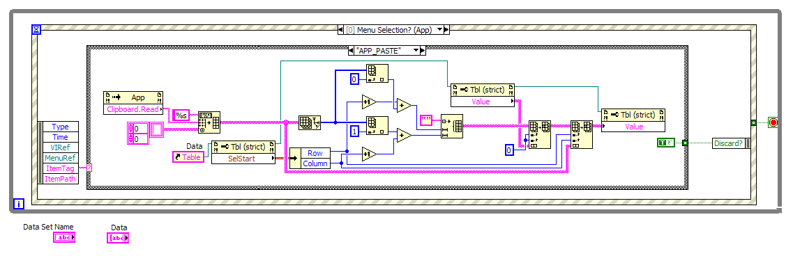

Weeeeee..... well, that was fun.
The only issue with the "Menu Selection? (App)" event is if I wanted to have paste features elsewhere.  I think I'll end up using a button for pasting...there is an issue with the attached code that if the user is "in" a cell, that cell doesn't get the pasted data.  There is also an issue if the user wants to paste a single string to a cell in my table as oppose to strings from an excel spreadsheet.
-nic
