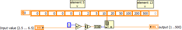

After rounding to nearest, you get an integer, so wire that to the case structure, remembering that is twice the indicator value. In fact, even simpler would be to create a 1D array of DBL values where the index covers 0 to the highest expected integer. No case structure needed! Maybe there is even a mathematical expression that could calculate the value from the input.
Here's how that could look like:
(3,722 Views)
Very clever!
I was trying the idea of doing a array search over the weekend, and the output being wired to a case structure.  I like the idea of bypassing the case structure - seems more efficient.
