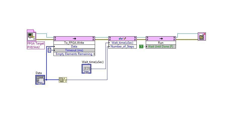

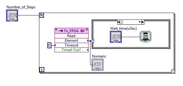

I am attaching my Host and FPGA VIs and their screen-shots. I tried to switch ON a TTL signal in one channel of Connector 0 of 7851R. After some wait time  (1 μs), I switch off the TTL signal in the channel (FIFO array sequence from the host is: 1,2,3). I see a nice TTL pulse on my oscilloscope but the above issue remains to be resolved.Top_level_Non_FPGA_VI_using_FPGA_FIFO_VITop_level_Non_FPGA_VI_using_FPGA_FIFO_VI
FPGA_VI_using_FIFOFPGA_VI_using_FIFO

Sorry for not replying for a long time. I was trying to figure out a solution. Right now I have thought a highly unconventional way of solving it. I use a DMA FIFO of U64 data type. Now every element of this FIFO requires 64 bits. What I do is partition these 64 bits to send the information from Host to FPGA regarding control values. Say I dedicate the first 10 bits to determination of case number. So I can only have about 1000 cases but that is sufficient for all my future purposes. The remaining 54 bits I will partition as per the particular case of the case structure. An example :
Suppose I want to call case number 2 which is the wait case but with different wait times for each call say first 1 µs and then 2 µs. So first ten bits represent the case number (in binary) and we have 0000000010. Now the remaining 54 bits will tell the values for all controls (here only one). For 1 µs we have "53 0s and then 1" and for 2 µs we have "52 0s and then 10". The total 64 bit binary numbers look like :
For 1 µs wait : 0000000010000000000000000000000000000000000000000000000000000001
For 2 µs wait : 0000000010000000000000000000000000000000000000000000000000000010
These two numbers I convert to decimal and supply to FPGA via DMA FIFO. So the numbers look like :
For 1 µs wait : 36028797018963969
For 2 µs wait : 36028797018963970
Now when FPGA receives these numbers, it will convert them to Boolean array, split the array to extract the 10 bits for determining case number and remaining 54 for control values. I know that that 54 bits may not be sufficient if number of controls in one particular case is more.
By the way all the cases will now have a crazy 64 representation. Suppose I want to generate a TTL pulse of 1 µs given that case 1 is switch ON the TTL signal, case 2 is wait, case 3 is switch off. Then the binary code is :
For Switch ON : 0000000001000000000000000000000000000000000000000000000000000000
For Switch OFF : 0000000011000000000000000000000000000000000000000000000000000000
For this operation, decimal numbers given to the FPGA via DMA FIFO are:
For Switch ON : 18014398509481984
For Switch OFF : 54043195528445952
The advantage now is using the same wait case I can generate any number of TTL pulse duration one after another. Say first a 1 µs TTL pulse, Then wait for 1 µs and generate another 2 µs TTL pulse. The code given to the FPGA is :
I have tested this method with a case having four control values in non-integer format also (e.g. 8.8, 4.76 etc.). Using partitioning of the 64 bits of U64 integer, I can rebuild the integer and non-integer part of a real number in FPGA once I recieve the U64 integer. I would like your reviews on this method.
