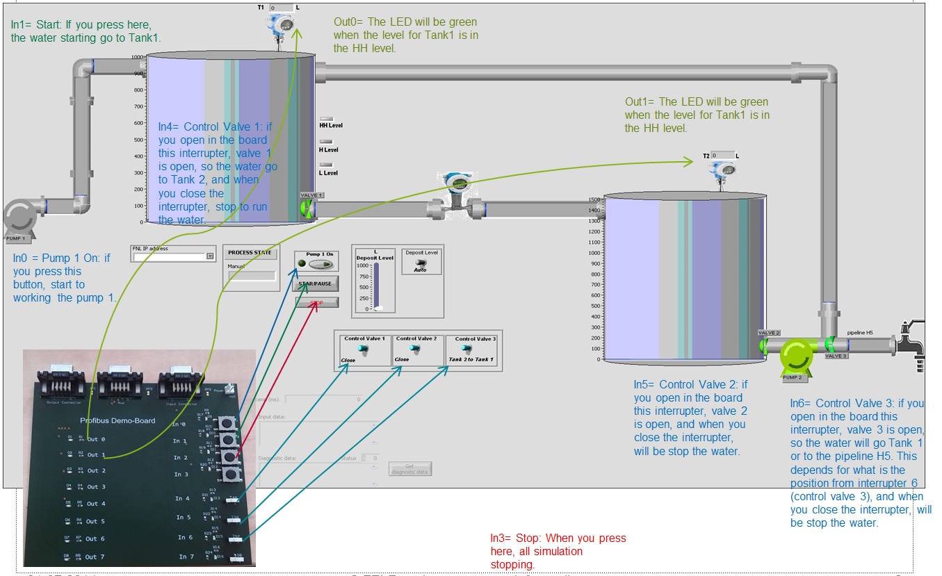

simulation
So my problem is I want  run different processes in the same time, without having to wait out the current process is running....
this look like this:
diagram
diagram2

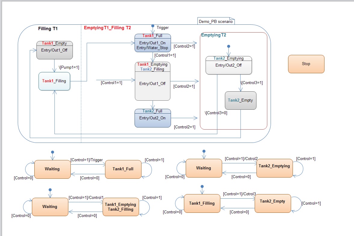

and with the differents states...so I was trying to use a Statechart for try to improve the simulation....
like this:
statecharts

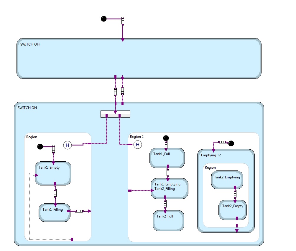

But when I was tried to implement in labview with the statechart module i can't find the way to interconexión with this new module...
StatechartLV
Because i need two differents regions...but i can't use the connexion between them....

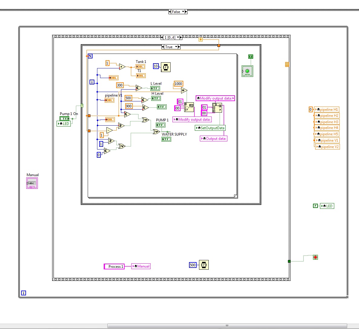

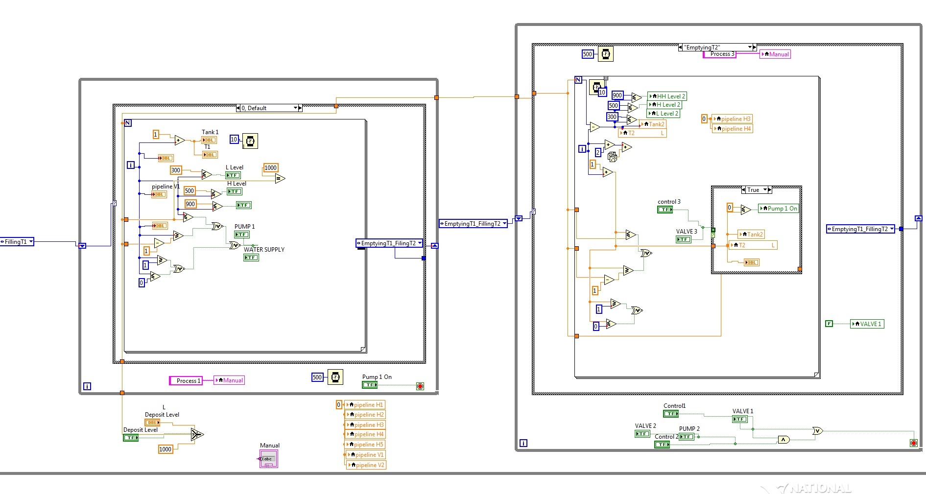

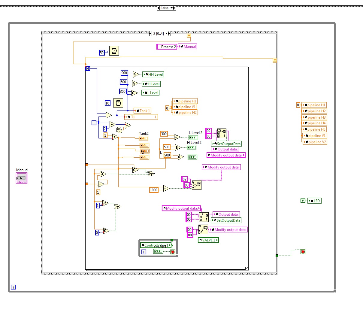

Well, I was trying with state machine...but I can´t controller my inputs now...I don´t know what I´m doing wrong....
now, look like this:
