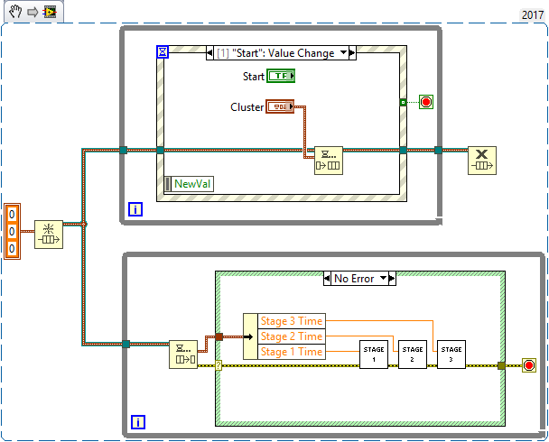

I've attached a zip file containing the VIs to run the example pictured below, which I quickly created.
The stages each call a Dialog VI, which displays the count-down and then closes.
Each stage can have a time specified in the caller.
If you were to reproduce something like this, I strongly recommend using a typedef for the data type of the Queue - otherwise changing it later will be difficult (and you may decide you want to pass more data, in which case you'll need to change it.
In this example, I used the error output of the Queue to terminate the loop. A more complete example might have a data element containing an Enum or String, and a Variant, and then a series of typedefs of different data (including the time duration) for different commands (enum/string). The Variant then contains the appropriate data for a given command. One of your commands can then be a "stop" command.
Taken to a slightly further level, you have the Actor Framework (where each message is its own class, and so the data is strictly defined without needing so many typedefs or any variants (but now you have lots of classes).
(4,747 Views)
I think I see where you are going with this...!  I like it. 🙂 How would the Caller know however when to execute stage 1, then stage 2,...and so on? Hitting start in this case - (as you said earlier, we know what delays we want to enter in ahead of time) does not initialize or start stage 1 currently.
(4,739 Views)
At least when I ran it on this computer, hitting start does execute Stage 1, 2 and 3. Is that not what you observe? Are you sure your delays were long enough to observe (the defaults will be 0s, which may just cause a strange flickering 3 times, I'm not sure). If so, try changing them to 2 or 3 seconds each to be able to see the VIs.
(4,737 Views)
Okay, weird. It is working now! I had chosen values for Stages 1,2,3 as 20,30,40 originally and nothing happened. I lowered the values to 2,3,4 and it took off running perfectly - go figure.  Thank you for the help! 🙂
