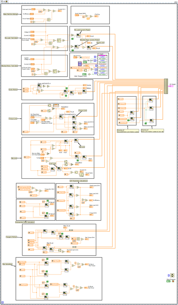

Well here is my VI, after using local variables. As you can see I have already used many SubVI wherever possible. With the use of local variables I don't have to back trace the wire to see where it is coming from, so it makes the VI more readable.

I am hoping the Sir CA can work his postage stamp magic, ie, reduce that diagram down to a postage stamp size. Smiley Wink
You can use queues, notifiers, user events, to share data among loops, although each loop will have a copy of the data.
I can not look at it in depth at the moment due to a plethora of meetings.
mcduff
Message 8 of 30
(7,190 Views)
Unfortunately, the forum does "pre-processing" of pictures before displaying them, so your snippet won't work.  You'll have to upload the snippet as a file.  I'm already afraid of what I'm seeing though.  You know that LabVIEW doesn't really flow left to right; it just appears that way because you connect the nodes together from left to right - usually.  That being said, the "floating code" that you have in there can execute at any time it feels, and if you have locals attached to it, you may or may not be operating with stale data.

LabVIEW is a dataflow language.  Unlike many text based programming languages data flows from source to sink along wires.  It is possible to create a Data Value Reference that does point to a memory location but, that is merely a "Hack" around understanding and using dataflow and its advantages.
Looking at your vi,  There is no data dependency between where you calculate" lo pt" and when you read the value via any of the 8 different local variables.  So, the calculation and the 8 reads can happen in any order!  Imagine, 4 reads of stale data, a write to the indicator and 4 reads of new data!  as an example!  without dataflow the values read are unknowable.  This is an unwise use of local variables!
