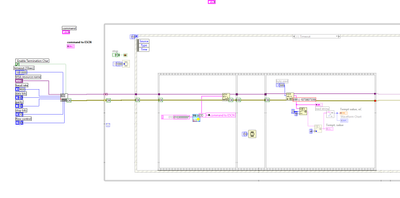

I use an Omron E5CN-H as a temperature controller, which has its own software, written in some low-level programming language, which works but doesn't integrate well with Labview, so I cannot easily keep track of all the measurements from other apparatus in an efficient maneer. I would like to control it with Labview, too.
I have found the thread https://forums.ni.com/t5/LabVIEW/Omron-E5CN-Drivers-Help/td-p/2136658?profile.language=fr&lang=en, in which nguyenxuanthai provides some Labview codes to take control of the apparatus. I have correctly input some parameters (such as the baud rate, the parity, the data bits, etc. which I had identified from the source code of the working software that can already control the apparatus), but unfortunately the code gets stuck in an infinite loop. An error is returned after a few seconds, as you can see in the attached screenshot.
I tried to input different number of bytes read, from 2 to 500, and the code always returns this error no matter what. It's as if the apparatus is unable to read the specified number of bytes, and times out, as far as I understand. The error is 1073807339.

Do you have the manual for this device?
You set the VISA Serial Configure to not have the termination character enabled.  It seems like that should probably be True.
Do you know if it uses a termination character, and is it a linefeed character which is the default setting since you don't have anything wired to that input?

Yes, I have the manual. It is rather thick, and I do not find any information about how to "talk" to the device from a connected computer.
Regarding the VISA setting, I didn't change the default value, but changing it to true does not change the error.
