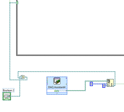

I am relatively new to LabView and I try to control case structure with digital signal. I use LabView 2020 and NI USB 6009. I try to control case structure with digital input signal, same as I can control it using the Boolean 2. I use the case structure to pause the program. So when the value is true the program runs, when it is false is paused. I test the NI USB 6009 and it read the signal correct. I really don't know what I am doing wrong. I think something must be wrong in this part of the Block Diagram:
And for controling stop button it works. I can stop program using digital signal connected to Dev 1/Port1/Line3 on NI USB 6009.
Hope you understand what I try to do. Thanks.

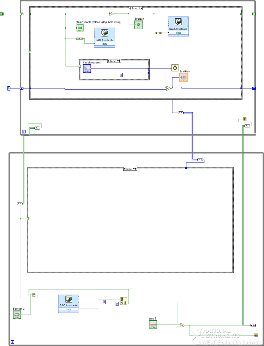

Here is program.

Hi jofu,
So to confirm a couple of aspects:
  • Your DAQ Assistant4 Read is set to read two boolean lines and invert them, line3 and line2 (in that order).
  • You then use Index Array with "0" wired twice. This gives you the "NOT line3" value twice (line2 is never used). As an aside here, you could just branch the wire if this is what you really want - if instead you want the "NOT line3" and "NOT line2" values, you don't need to wire anything to Index Array's indices - you automatically get 0, 1, ... if you don't connect values.
  • When "false" is the output, you're not actually 'pausing' the program - you will run the code fairly quickly (as fast as your DAQ device can supply values, which is not very determined here due to the use of "On-Demand" sampling).
I expect the problem you're running into is related to your Index Array inputs and getting the same value twice, but perhaps you can clarify what behaviour you want if this is not true.
Message 3 of 13
(4,614 Views)
Thanks. I deleted the "0" wired to the Index Aray and now it works properly. Thanks again for the help.
