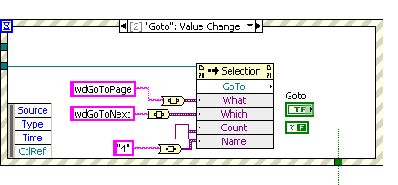

I'm trying to control the pages displayed in MS Word by jumping to them. I can jump to previous, and next, but I can't jump to a page I want to.
I know I am doing something wrong with the invoke node (see below, full code attached), but I don't know what because I don't know the syntax (if that's the right term, please correct me if I'm wrong).
I have tried just about everything, but it doesn't like it!
The macro command is:
Selection.GoTo What:=wdGoToPage, Which:=wdGoToNext, Name:="2"

Hi Andy,
use the "wdGoToPage" constant, as you do for the other functions.
See the attached picture.
You can connect the new page also as string.
Mike

Mike,
That's great! Thank you!Smiley Happy
It works perfect. I was going to add a control to set the page number, but didn't as I was struggling to get it working in the first place.
Thanks for showing me how to wire up the Close Reference too, I was wondering how to do that.
