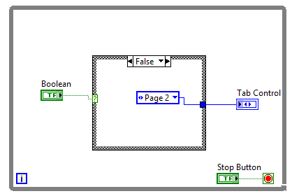

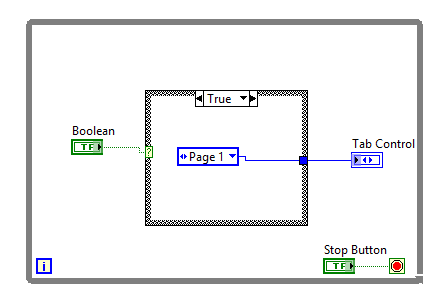

I did a little code to command 2 pages of tab-control with boolean.

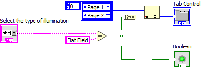

Here's what I would probably do (and hide the tabs).
