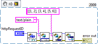

How are you building your string? When I sent a simple string constant using the server code below, I get just that value back. What client do you use to retrieve the data?

[Are you using the new png feature?  How does that work?]
My code looks like this.  The build spec maps the URL to this VI and the output is sent back.  My client is a browser web framework that issues the request to the cRIO and displays the results.
(4,137 Views)
Ok, it look like you're using the terminal method as opposed to the stream method... Let me see if I can reproduce this...
Are you using Labview 2009?  You can find out about the new PNG VI snippet feature here. Basically you can drag and drop the images of code onto your block diagram!
Again, how are you invoking the web service and getting the information?
Misha
(4,134 Views)
I see what you're talking about. For now, I don't immediately see any options that will allow us to eliminate the name of the output terminal from the resulting string, but depending on how you're retrieving the information, you can parse that part out. For example you can use datasocket to invoke your web service with this connection string:
