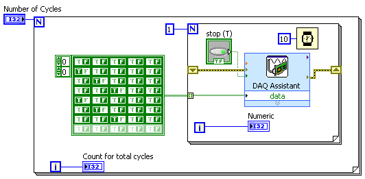

Thats not working because its 7 "for loops" inside a larger "for loop."  I need some type of counter but the ones i tried wont work.  Ill attach the code so you can take a look.  Thanks

Except for your first inside loop, the others should count fine.  Put the Numeric indicator for the first loop inside the loop.  They all will just count to 0 because you wired a 1 to the N.  That is telling the loop to run just once (the i starts at 0).  Now the outer loop will run again, but the inner loops will all start at 0.
Each loop should have a small delay, Wait(ms), in it to prevent using 100% CPU time.
You don't need a conditional stop in the for loop unless you want to abort manually before the number of cycles is reached.
There is a better way to do what you are doing.  Each loop contains the exact same code except for the boolean array.  If you create a 2D array from each boolean array, and pass this 2D array to just one loop,  each row of the 2D array will be fed to the loop for processing.  The following code will do the same as your huge block diagram.

Thanks I will try the other way too.  It still will not keep count in the rest of the loops, the only one that works is the complete cycle indicator?  Is there any other way that i could count each loop by some built in counter or anything else bc i need this to work?  Thanks tbob

The “Count for total Cycles” indicator will tell you how many times it has already iterated, and each block of Boolean data will go once for vector of digital data you give to the DAQ assistant. There is one small error in the code posted by tbob. The constant “1” connected to the inner “for loop” will cause it to end early. If you remove this value you should get a better experience for that code.
