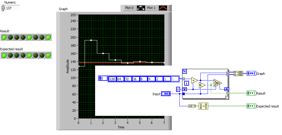

To sum this up, here's a quick implementation for 8 bits. (Of course you could calculate the input constants based on N and i inside the loop)
