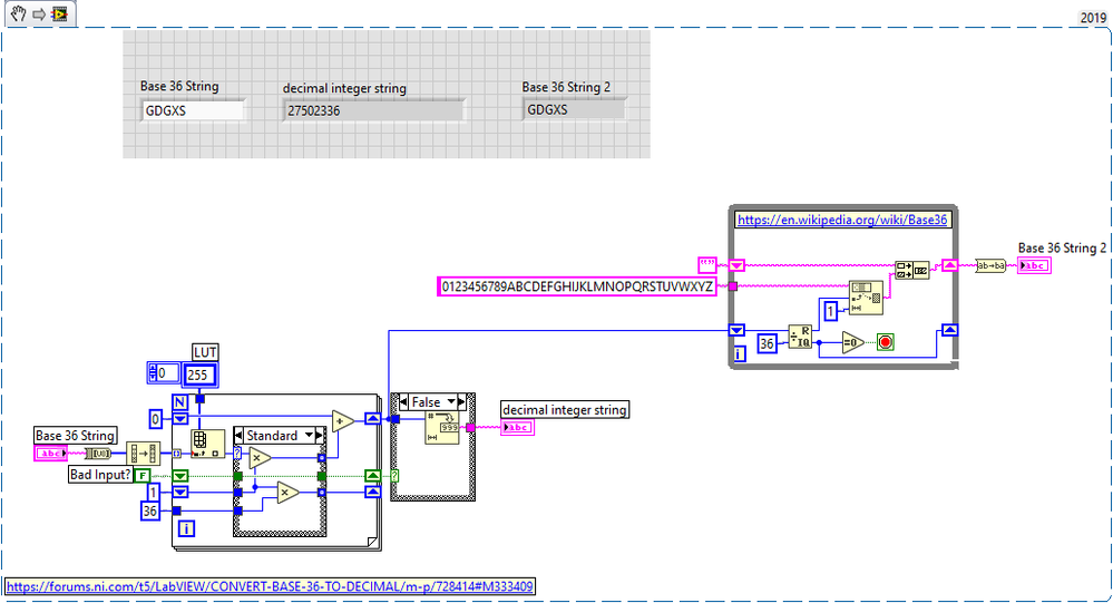

Many thanks for posting that version Alex. I've managed to adapt it into converting my 1D array.
Message 9 of 11
(7,609 Views)

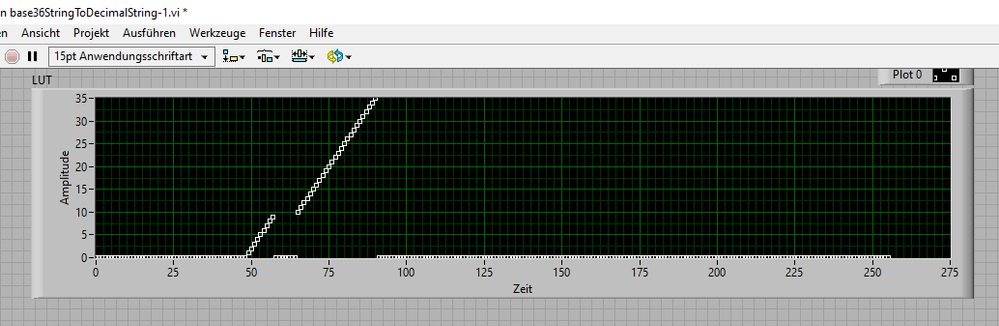

That version does seem a little cleaner. I'm not sure how a matrix just full of 256 0's can be considered a lookup table, however. What is being "looked up", just the index position?
he posted a previous version, which is easier to read :
base36StringToDecimalString.vi ‏10 KB
 it's not completely filled with 0 - there are 35  non-zero values
what do you think do  these numbers represent?
Smiley Wink
there's also a reason, why there are 256 elements in the LUT
you may also want to read the quite short help for the "string to byte array" function
https://www.ni.com/docs/en-US/bundle/labview-api-ref/page/functions/string-to-byte-array.html
