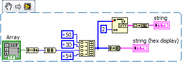

the problem i have that i need to send hex string with lingth of 4 as (503D XX54) and the value of XX must change from (0 - FF) by switch array so i made constant strings (503D) and (54), and string (XX) must change by Switch array  then the three strings collected togather but with difreent format  so please if anyone can help me to solve this problem

Hi soliman,
the problem is you didn't provide any default data in your controls nor did you really describe what you want ("hex string with lingth of 4 as (503D XX54)" - that's a length of 9 chars for me...).
There's a difference between a string in hex display mode or hex numbers or simple strings! But that has been discussed so often in the forum you could easily find threads discussing your question... (Why the hell you're using mathscript to convert a number to a different number?)
In the meantime you may play with that:
17501iD36BAEEE083DF07D
Message 6 of 11
(27,433 Views)
hi sir
i realy thank you alot GerdW because your advise helpt me so match in my project
 with all of my respect
and thanks again and again
