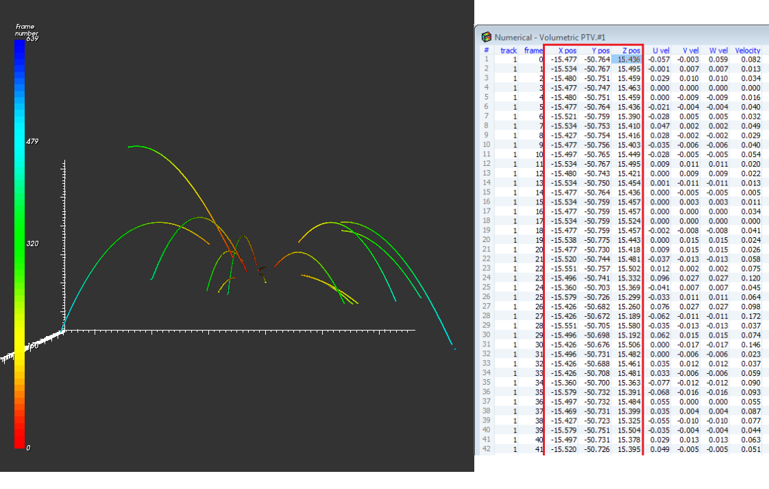

I've got many trajectories which consists of particles with their XYZ positions like on the picture below:
 Now, I would like to convert each trajectory to 2D (X,Y) along its direction and have got it as I called "flat". Each trajectory is in another direction so is there a chance do convert it like this: first trajectory converted along itself, second trajectory converted along itself e.t.c. Is there a chance to make it in LabView? Please, help me

Actually i went and over-complicated it.
ground range=(x^2+y^2)^0.5
plot z vs ground range.
Simples...
Message 5 of 16
(5,016 Views)
Oh, they don't all start at the origin, so it's:
ground range=((x-x0)^2+(y-y0)^2)^0.5
where x0, y0 are the coordinates of the first point.
Message 6 of 16

@ToeCutter
I know that You took this equation as a distance between two points on 2D plane but it looks so simple when we plot this with Z cooordinate. We don't know how to check if it's rght.
Message 9 of 16
(4,932 Views)
It's so simple, I can't see there's room for error- plus if it's wrong it will get torn down by another poster.
Simple tests:
Create your own trajectory in the x-z plane. Transform, compare graph with range-z - they should be identical.
Create one in y-z. Same game.
To echo a previous post- please don't create multiple threads on the same subject as it wastes time for us, and we do this for free.
