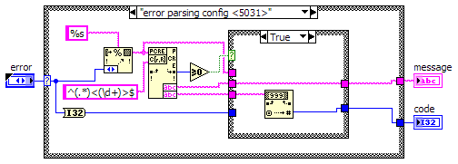

I would like everything within the case structure to be "universal" (i. e. independent of the "error" typedef). The typedef is part of an error handler. The reason is that until someone created/translated meaningfull error messages I'd like to automatically determine the values from the enum itself (the numbers between the angled brackets define the code, the string before that the preliminary message). While the structure is identical, I have serveral of the "error"-typedefs containing different sets of values. I'd like to use the same subVI for all of them instead of creating one for each typedef. The snippet you see already is specific for each typedef (although the structure again is identical for all) and I don't want to add another layer of specific subVIs.
The enum is converted into a string simply by "format into string". Nothing special there.
Casting the typedef'd enum into a non-typedef'd using "type cast" does not really work, because every time I change the typedef I also have to update the non-typedef enum that is connected to type cast. This means this wont work in the way I'd like it to:
So in principle what I need is the "disconnect from type def" just in a programmatic way.

Yes, this does what I was looking for. Not quite happy with the "black box" vi (GetNumericInfo.vi) that's password protected, though. I like to know what's going on and who knows what happens with it in later versions of Labview. But as this is from NI I guess it's safe.
Now that I come to think of it, the question was a little bit off for what I need. I don't really need the whole enum to be made "typeless". A better question would have been: how do I get the numeric value and the string of the currently active element of an enum, no matter what type the enum is? Maybe something that could be called "enum to cluster" which gives me a cluster containing the numeric and string value of the currently selected enum value. Because in my case for the subVI I don't care what the other items of the enum are.
Seeing that I maybe just convert the enum to string and numeric value (as seen in the screenshot above) in the typedef'd enum specific VI and call the "universal" subVI with these two values. It's just one more function in the calling VI (although admittedly for ervy entry of the case structure) and much less additional code in the subVI ("and especially no black box").
