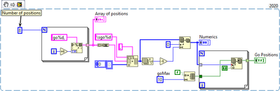

Something like this work?
(Haven't seen the code yet)
James
CLD; LabVIEW since 8.0, Currently have LabVIEW 2022 SP1 installed

(5,050 Views)
Use a case structure as Renaldo said, creating a case for each possible outcome. Every case defaults to "False" and the selected case goes to "True". Take all of the Boolean outputs and build them into an array and create an indicator for this array. Create a property node for this indicator so you can reset the LED's to all "False" at the beginning of the vi. The proper LED in the array will stay lit until the vi is run again.
Message 9 of 27
(4,993 Views)
So nothing like the code I posted at all???😉
the only thing wrong is the simulation of the go string and breaking it out into multiple processes.
It could be done as one function instead.
James
