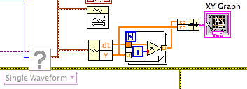

For a waveform the elapsed time from the beginning of the waveform is dt*i, where dt is obtained by using the Get Waveform Components primitive on the Waveform palette and i is the index in the Y array of the element you want.  To get an X array simply use Ramp Pattern.vi with appropriate inputs or a for loop with the Waveform Y array as an autoindexing input and dt*i as the output.
Also, you do not need the Express VI for simple graphs, a Bundle from the Cluster, Class and Variant palette will do, using much less BD space and leaving no doubt about how the graph data is formed.
