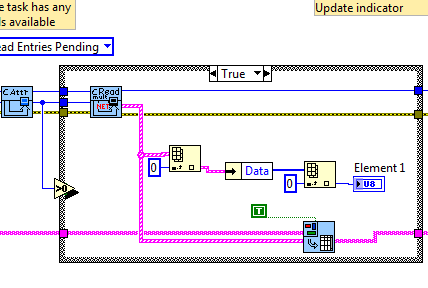

It sounds like you are getting the data but having trouble accessing the raw decimal value of the first element in your LIN frame. The raw data comes in as an Array of Clusters.
As you can see here,
AccessLINRawData.PNG'
To access the data, we can index the array to get a single LIN Frame, and then use unbundle by name to get just the U8 Array of data, after which we can index array to get the single first element from the frame. You can then use that data in LabVIEW however you need it.
