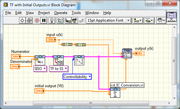

You can find that VI here
C:\Program Files\National Instruments\LabVIEW 2009\vi.lib\addons\Control Design\_Time Response Analysis\Time Response.llb\Time Response subVI\cd_IC Conversion VI
Something like this should do the trick.
Andy Chang

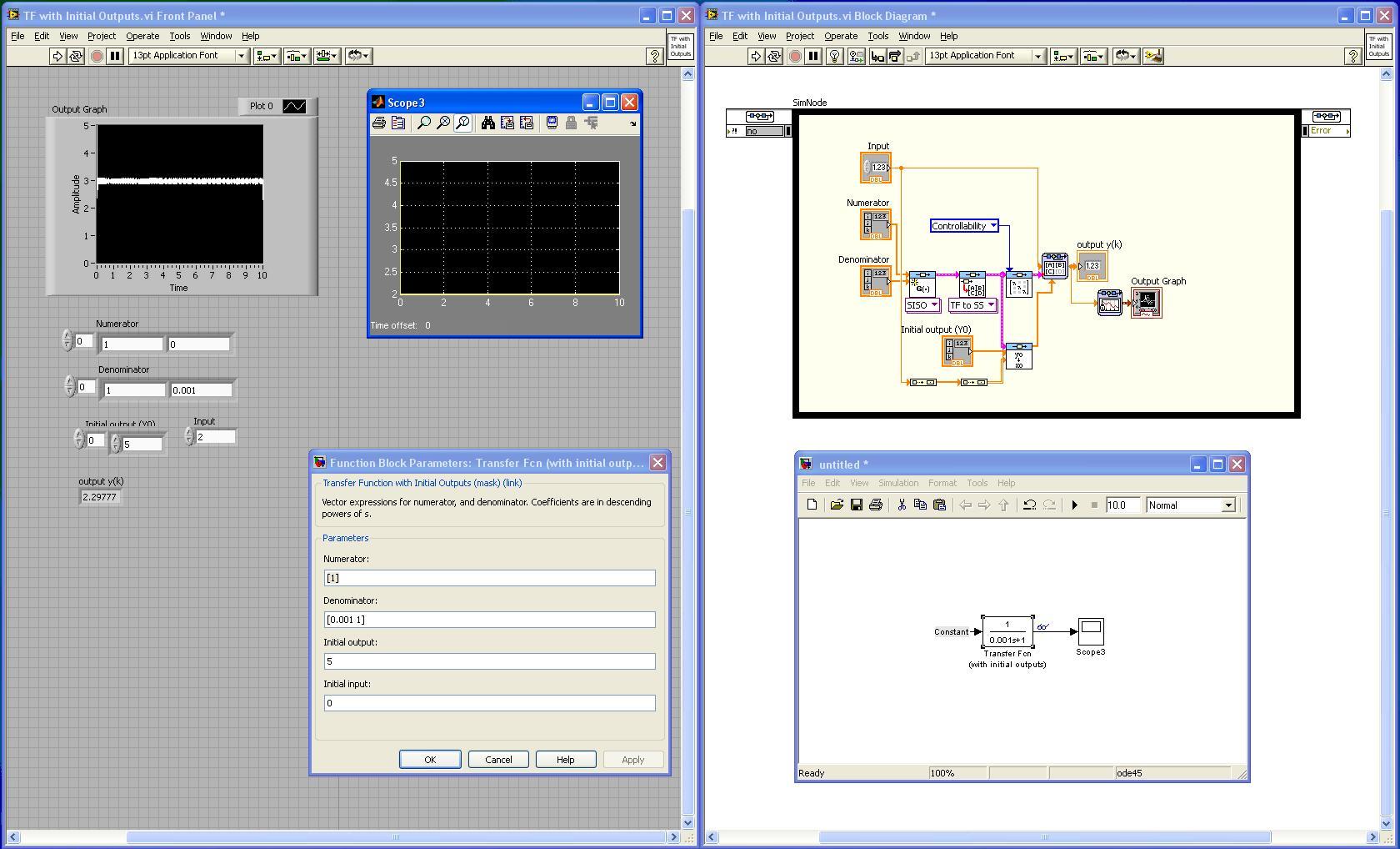

Hi Andy,
I build the example you gave. I did some testing but I gets a different results when while running both TF in Simulink and LabVIEW. Can you check if I'm doing it right? I posted the image of the both simulation below.
Btw, I was wondering how could I set the initial input in LabVIEW?
Thank you.

Here's a screen shot from my result which looks correct.
Could you post your code here?
I have posted an example on TF with Initial Condition, which you can find it here.

Hi Andy,
Attached is the VI I created following the first model you post. In Simulink, there are 2 initial conditions. One for the initial input and the second one for initial output. How could I implement that using the model you created?
Thanks.
