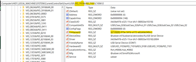

That could be a fallback strategy! The main issue is when your device doesn't have a mechanism for reporting its serial number, and by relying on individual serial command grammars to properly cache, you lose the generalizability of the code (you need to implement a VI for each new type of device to do this mapping).
Here's where the "ContainerID" comes from, it's not something from the grammar, but within the registry itself. This is how you can uniquely identify a serial device (even within a group of devices with the same vendor and product IDs)
