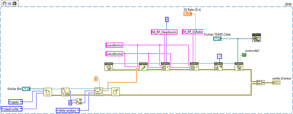

I am looking to convert a “. bin” binary file into a TDMS file so that it can be read by RFSG SFP (Soft Front Panel).
From what I read, the requested properties are the signal name, the header size and its I/Q rate.
So what I’ve done for now is to open my “. bin” file, retrieve the data from it, provide it to the TDMS file, and then add the necessary headers using “Define Properties.
There -below a picture of my code:

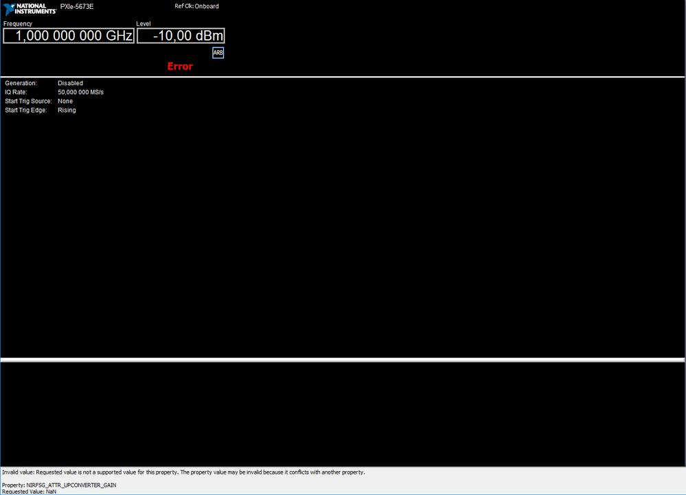

The problem is that when I try to read in RFSG SFP, I get the following error :
So my question is, how do we solve this problem? Do I need to add an additional header?
Apparently RFSG expects some UpConverter_Gain property, which is missing in your TDMS file…
(I haven't worked with that tool, but can't you create a TDMS file with RFSG and then analyze it to learn about all the needed properties?)

That is the whole problem.
To create my code, I first analyzed two sample files with the TDMS “List component” tool. These two files had several headers:
ChannelLength, Data-Type, Headroom, IQ_Rate, WaveformType,dt and t0.
Then I tried to put it on another “. bin” file, and it worked. I then narrowed it down to headers. Data -Type, IQ_Rate and Headroom, and it still worked.
But for a simple cosine written to a binary file, it asks me for a new “UpConvert_Gain” parameter that was not needed before.
That’s why I wanted to know if a general specification exists and which works for any . bin file.
