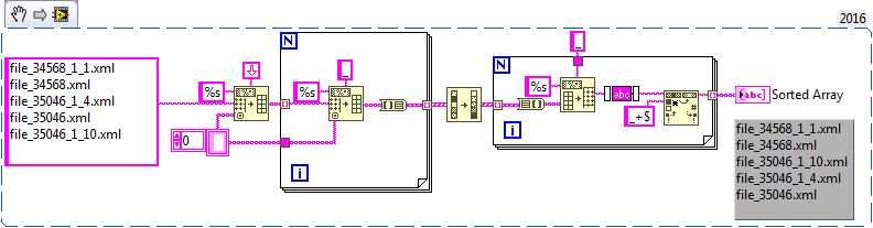

Another approach is to convert filename to a cluster of string (using the underscore as a separator), then to sort the resulting array of clusters (all the filenames) and then to convert back the resulting sorted array of clusters to your filenames.
