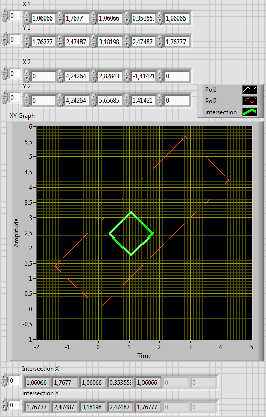

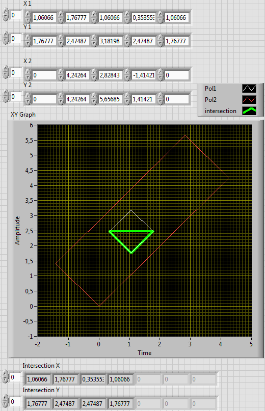

in my project I used function Convex Polygon Intersection VI (new in LabView 2012) and it seems that it doesn't work correct. In some cases the result is not correct (see image). The result is correct when I re-type inputs from double to single (although this function inputs are defined as double) but I'm not sure whether this solution is guaranteed for every input values or not.

I agree that the function is buggy.  If you translate object 1 in X by 0.00001, then it gives the correct intersection.  That could be why it works for SGL inputs - the values end up very slightly different when converted to DBL, and therefore work ok.

Math VIs shipping with LV can be very frustrating.  Besides what Greg mentions as obvious shortcomings, it can seem that little testing is done.  In computational geometry you have to check regular cases (colinearity, regular grids, etc.).  Here a simple diamond pattern screws up, don't worry about DBL/SGL changes or thinking you have a random set, enclose the points [{1,0},{2,1},{1,2},{0,1},{1,0}] with a large polygon, does not matter what shape.  It screws up and the culprit is Polygon Intersection_Rm Duplicated Vertices.vi.  The point of the VI is to determine if three points are collinear and the middle one can be removed, but you can tell by inspection that it screws it up.  It thinks move left one and up one, followed by move left one and down one is following the same line and removes the middle point.

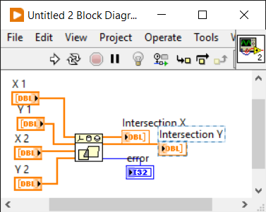

In LabVIEW 2020 Convex Polygon Intersection VI returns extra vertice - first and last vertices are the same.
