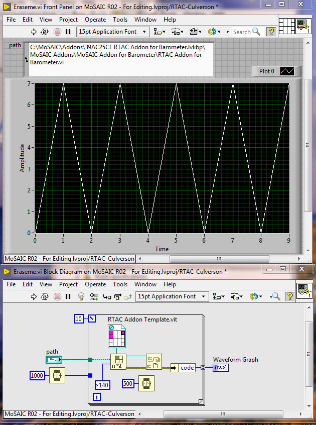

If I open/close the reference 10 times:
If that opens it NINE times, I'll get 0-7-0-7-0-7-0-7-0, then the NEXT run will start with the error first, 7-0-7-0....  That means there's something in the system that remembers that it's supposed to fail, or not.
