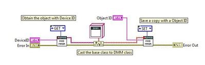

I'm doing some LVOOP. I load a NiDMM plug-in class dynamically using the factory pattern and save the object(dmm1) in a Variant FGV using the set variant attribute . I want to create many objects of the loaded class. The way I am doing it right now is I am making copies of the loaded class by Getting the saved object(dmm1) by it's name and Setting it again under a different name (dmm1_obj1).New objects.JPG
The copied objects, on writing new values to it's private property, retain the data, have diiferent properties on reading from the FGV and is working fine now. But  would like to know if there is a right way of doing this
Try working by wire.
Storing everything in a universal (global?) container might be really convenient at first. It's also probably much more complicated then needed.
Any time I have an array of objects, I have either an array of objects (duh), or a child containing an array of objects.
I know all those required wires seem like a terrible idea. But storing objects by labels doesn't scale well. At some point (parts of) your code needs to be started twice. All labels would need to be modified. It could be disastrous.
How would concurrency (two loops working on the same objects) work? Well, it should be avoided. When one loop needs (results of) another loops object, send it with an event. More work to program (maybe), but easier to comprehend and debug IMHO.
Parallel access to shared objects seems fun at first, but sooner or later you'll need to add interlocking\synchronization glue code. That usually spoils the fun for me.
All in all it's not a terrible choice. Lots of people use it all the time, I assume. Just know the risks.
