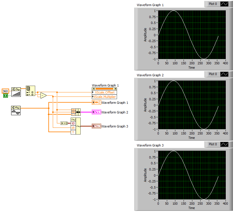

Here are three possibilities. All give the same result. (I typically use the middle solution)
Now all you need is to label the x-axis differently.
Message 3 of 9
(4,578 Views)
In Altenbach's post, notice the wire color of his three Waveform-like Clusters.  One is a 2-element Cluster (lacking X0) of Dbls, so is "reasonably" an Orange wire/indicator; one is a three-part Cluster of Dbls that includes X0, and it has a pink wire and indicator; and the last has the X0 value converted to a Timestamp, and has the brown appearance of a waveform.
Altenbach prefers the pink solution -- so does NI!  If you look in the Waveform Palette, you can find a routine that does an FFT of a Waveform and outputs a pink Cluster with components f0, df, and an array for spectrum magnitude.  Makes sense to me, too.
No, the first one is a plain 1D array, setting the scaling with property nodes. (there is no 2-element cluster on my diagram)

@Bob_Schor
Bob Schor
Are you sure NI prefers the pink solution? I know I do, but when I look at the Waveform Measurements or Conditioning Palettes they all have the brown wire for the input.
mcduff
Message 6 of 9
(4,547 Views)
Because they are all time waveforms in the waveform palettes.
The FFT is not a time based waveform but a frequency based waveform.
