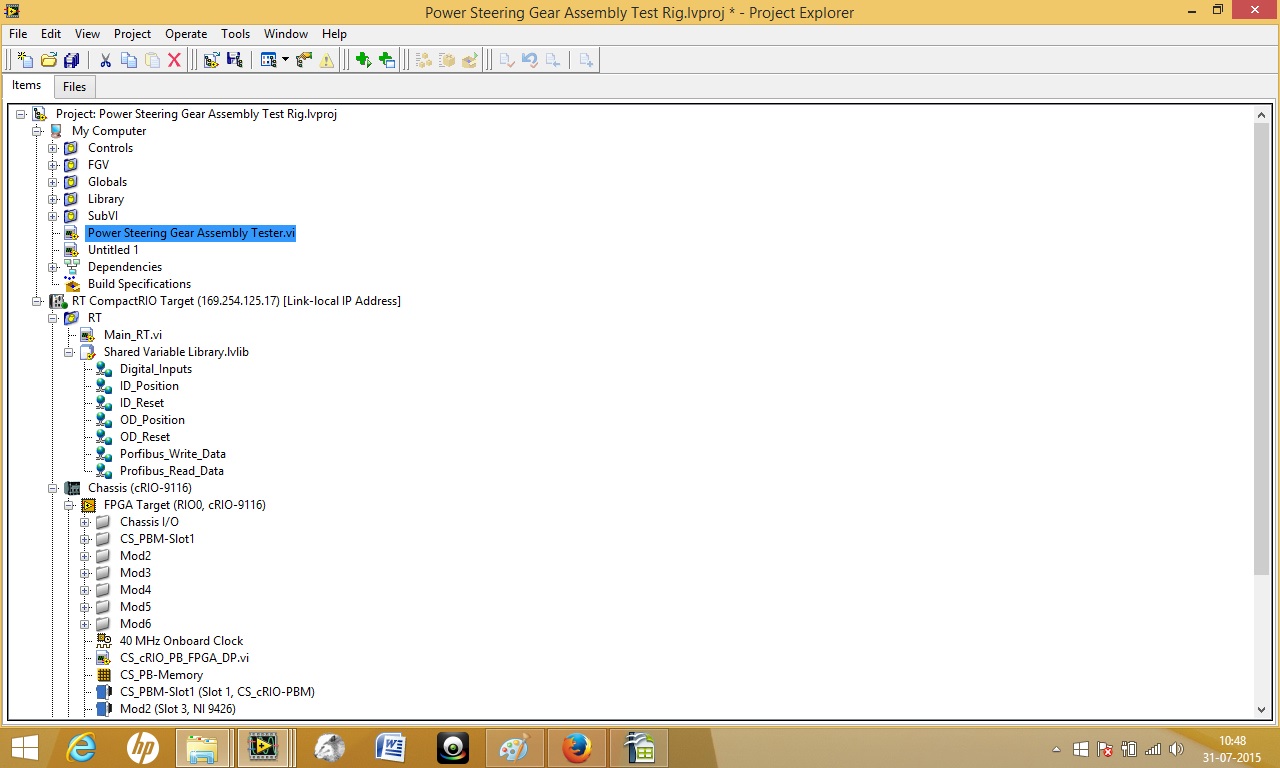

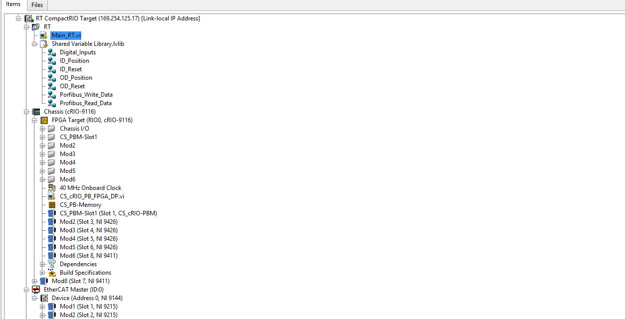

This is how I have configured my project.
Waiting for suggestions

1. I am assuming by Host VI you mean Main_RT becuase it is what is highlighted in your picture, is this correct?
1. No my host VI is in PC - which is highlight in the above image

Problem i'm facing is
I'm having a VI which contains shared variables from RT, also Module I/O from 9144 EtherCAT chasis.
The VI is in Host - PC, if i run it, started deploymeny and hangs on. thats it. it is not continuing.
Will any problem arrives when EtherCAT variables and RT varibles deployed?
