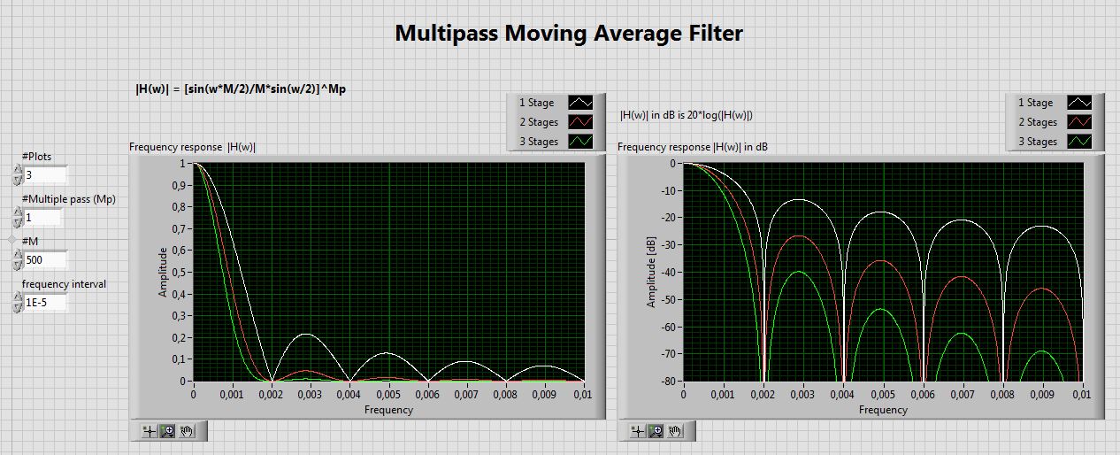

Hey guys,
here is a picture of the frequency response of a multipass moving average filter. The number of stages tells you how often the data is passed through the filter.multipass.JPG
As I am interested in the different slope behaviours of the different stages I wanted to ask you how to determine the slope.
Do I take the envelope to calculate the roll off (=slope) of the filter?
Actually it should be 1 pass (= 1 stage) is 20dB/Dekade, 2 passes = 40dB/dekade and so on...

You should set the plots to semi-log: vertical axis in dB, and horizontal (frequency) axis in log scale. The slope should be the envelope of that curve.
For example, a 20dB/decade falloff from 0.003Hz 0.009Hz is 9.5dB (20*log10(.009/003)). Your 1 stage filter (white line) is about -13.5dB at 0.003Hz and about -23dB at 0.009Hz, a difference of -9.5dB.

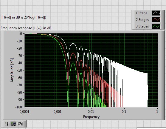

Hey,
thanks for your help. But I do not understand why 0,003Hz to 0,009Hz is a decade?
But I converted my x-axis to log and although I do not have a real envelope, but it is much easier to read out the roll off.MA frequ. response log.JPG
So if you take a line/function which connects all the maxima you would have the envelope and therefor the slope I guess.
Any comments regarding my theory?
The approach approves at least the 20dB and 40dB per decade.

Nobody said .003 to .009 Hz is a decade, jamiva stated that if you have 20dB/decade you should have around 9.5dB in the range .003 to .009 Hz, which corresponds to your data.
But you can see the 20dB/decade easily in the log/log plot.
