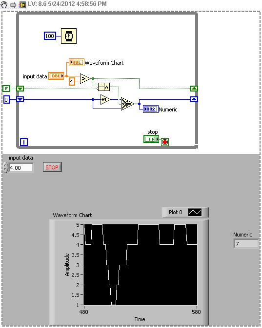

You might want to consider just doing your own comparison.  If the value is greater than 4V AND the previous value was less than 4V, increment.count.png

That's an interesting solution.
I'm searching examples for anything that looks remotely like this, with no luck.
Question...  If you wanted to have the option to reset that example you just posted, what would you do?  Like an option for pause and/or reset, while the main program is running?
For a pause, I would add it to the AND logic going into the select.  For the reset, I would add another select - true = 0, false = count value.

Maybe I'm missing something, but when I run that example, if I just leave it set to, say, 4, it will continue to count up.  That's not exactly what I'm going for, I need one increment on the 'leading edge' so to speak of the signal.  So once per pulse.

I found a way to use a feedback node to give an instantaneous 'rising edge' action, and that seems to work.  Both of the booleans before the 'and' seem to go true.
The output of the 'and' never goes true, and it never increments, though.  It seems that, upon slowing execution of the loop, that both of the inputs are not true at the same time, one goes after the other.
Any way to time that so that they happen simultaneously and perform the increment?
Attached the revision.

Hi Ralph,
did you notice the small circle on the 2nd input of the AND in the example in message#2? It has a meaning and it's important for you.
Hint: use RightMouseClick on that input...
General hint: when recreating other people's example you should pay attention to every and all items Smiley Wink

OK, I inverted that input and it sorta works now.  I say sorta because it's sporadic.  Sometimes it doesn't recognize the click.
